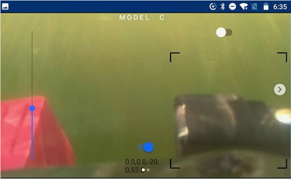

1. This post included a screenshot from July, and (thankfully) we've improved lot about the app. I'm really glad you bring this up so people can see the app in its current state. Here's a screenshot from the newest version of the app:
You'll notice those decimal values under the left, vertical, and right prop icons. You're absolutely right - these are the thrust values being sent from the app at any given time. In this case, all the thrusters have a throttle value of 0, because I'm hovering over a pool ring target.
2. Yes, in the next version of the app, you'll be able to click the camera icon to capture video! I'm planning to upload that to google play later this week, or early next week. Expect a walkthrough on this forum when I do ;)
3. Thruster direction and speed is controlled with the "trackpads." The trackpads are the regions that are cordoned off by the white lines (i.e. bottom left, bordered with "up" and "down" and bottom right surrounded by the white corners). These areas listen for finger contact, and translate your thumb's location on the screen to throttle values to send to the ROV.
To control vertical thrust, you'll place your thumb on the left trackpad. The middle line corresponds to a zero throttle value for the vertical props. To throttle down, move your thumb down, and to throttle up, move your thumb up. The top and bottom lines correspond to maximum (100) and minimum (-100) throttle values, respectively.
Controlling horizontal movement with the right trackpad is similar. Moving your thumb forward (or up in the picture) throttles the horizontal thrusters to move forward. Backward corresponds to reverse thrust, and moving your thumb to the left and right sides of the boxes will throttle the motors to rotate the ROV left and right, respectively. Any other location inside the horizontal controller will give you a pretty intuitive combination of thrust values. For example, full forward and left will let you carry out a wide left turn.

Could you please give some details on the interface layout and control? Sliders, square on the right etc, specifically:
1- numbers bottom centre (0.0,0.0,-100,0.59)? Is this the current thruster commands from the app or something?
2 - I've seen pics that has thruster icons top left and the camera servo lock / unlock and motor off slides (camera and motor buttons on pics here I think). I take it other buttons grab photo or turn on/off video recording?
3 - thruster direction and speed e.g. forward, reverse, left (port), right, (starboard).
